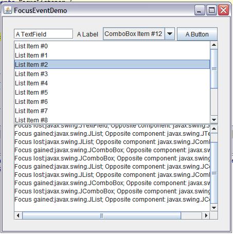

    public class FocusEventDemo extends JFrame
    implements FocusListener {
    public FocusEventDemo() {
       JComboBox comboBox = new JComboBox(/**/);
       comboBox.addFocusListener(this);
       add(comboBox);
    public void focusGained(FocusEvent e) {
       System.out.println("Focus gained");
    public void focusLost(FocusEvent e) {
        System.out.println("Focus lost");

    package ua.kiev.mabp;
    import java.awt.*;
    import java.awt.event.*;
    import javax.swing.*;
    public class FocusEventDemo extends JFrame {
    final static String newline = "\n";
    JTextArea display;
    public FocusEventDemo(String name) {
    super(name);
    public void addComponentsToPane(final Container pane) {
    final JComboBox searchCombo = new JComboBox();
    searchCombo.setEditable(true);
    final JButton okButton = new JButton("OK");
    searchCombo.getEditor().getEditorComponent().addKeyListener(new KeyListener() {
    public void keyTyped(KeyEvent e) {
    System.out.print("keyTyped");
    public void keyPressed(KeyEvent e) {
    System.out.print("keyPressed");
    public void keyReleased(KeyEvent e) {
    System.out.print("keyReleased");
    try {
    String s = (String) searchCombo.getSelectedItem();
    boolean enabled = (!(s.isEmpty() || s == null));
    okButton.setEnabled(enabled);
    catch (NullPointerException npe) {
    okButton.setEnabled(false);
    add(searchCombo);
    add(okButton);
    pane.setLayout(new GridBagLayout());
    setPreferredSize(new Dimension(450, 450));
    ((JPanel) pane).setBorder(BorderFactory.createEmptyBorder(20, 20, 20, 20));
    public static void main(String[] args) {
    javax.swing.SwingUtilities.invokeLater(new Runnable() {
    public void run() {
    FocusEventDemo frame = new FocusEventDemo("FocusEventDemo");
    frame.setDefaultCloseOperation(JFrame.EXIT_ON_CLOSE);
    frame.addComponentsToPane(frame.getContentPane());
    frame.pack();
    frame.setVisible(true);
    магия
