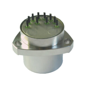

    2.Gyroscope
    The gyroscope (Gyroscope, GYRO-Sensor) is also called the ground sensor. The traditional structure is that there is a gyroscope inside, as shown in the figure below (three-axis gyroscope). The angle between the vertical axis and the device is calculated, and the angular velocity is calculated, and the motion state of the object in the three-dimensional space is judged by the angle and angular velocity. The three-axis gyroscope can simultaneously measure 6 directions including up, down, left, right, front and rear (the composite direction can also be decomposed into three-axis coordinates), and finally the movement trajectory and acceleration of the device can be determined. That is to say, the gyroscope judges the current motion state of the device by measuring its own rotation state, whether it is forward, backward, up, down, left or right, whether it is accelerating (angular velocity) or decelerating (angular velocity), All can be achieved, but to determine the orientation of the device (east, west, north and south), there is no way for the gyroscope to do so.
    The traditional gyroscope is mechanical. With the development of technology, there are also vibrating gyroscopes, laser gyroscopes, micro-electromechanical mechanical gyroscopes, etc., both in terms of volume miniaturization, measurement accuracy and ease of use. improve.
